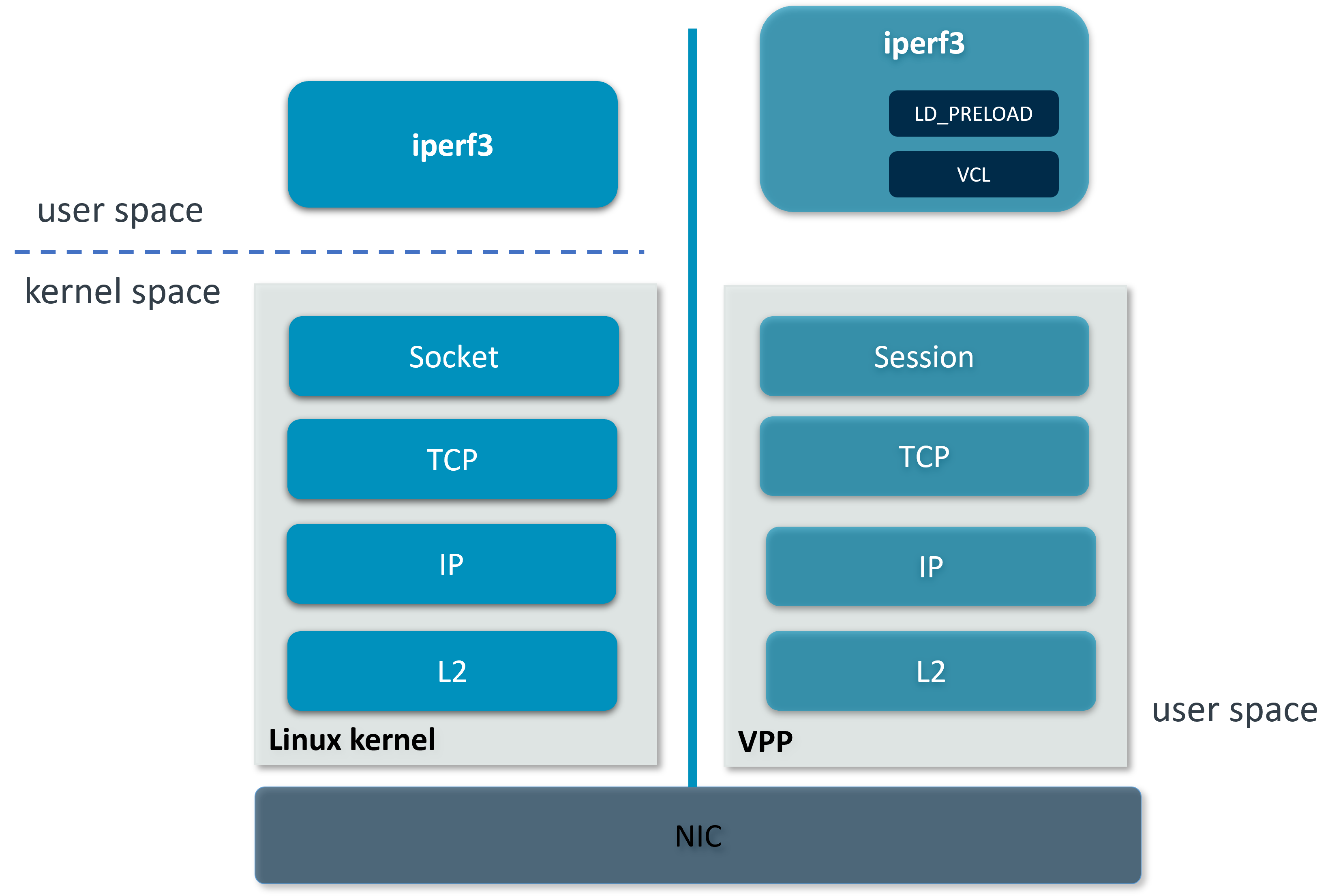

Network Stack Layers
../_images/kernel_vpp_stack.png
Linux kernel stack VS VPP’s host stack.
VPP’s host stack provides alternatives to kernel-based sockets so that applications can take full advantage of VPP’s high performance. It implements a clean slate TCP that supports vectorized packet processing and follows VPP’s highly scalable threading model. The implementation is RFC compliant and supports many high-speed TCP protocol features. VPP’s host stack also provides a pluggable transport session layer that abstracts the interaction between applications and transports using a custom-built shared memory infrastructure. There is also VPP Comms Library (VCL) included to ease the consumability of the stack from application perspective. VCL manages the interaction with the session layer, abstracts session to integer session handles and exposes its own asynchronous communication functions.

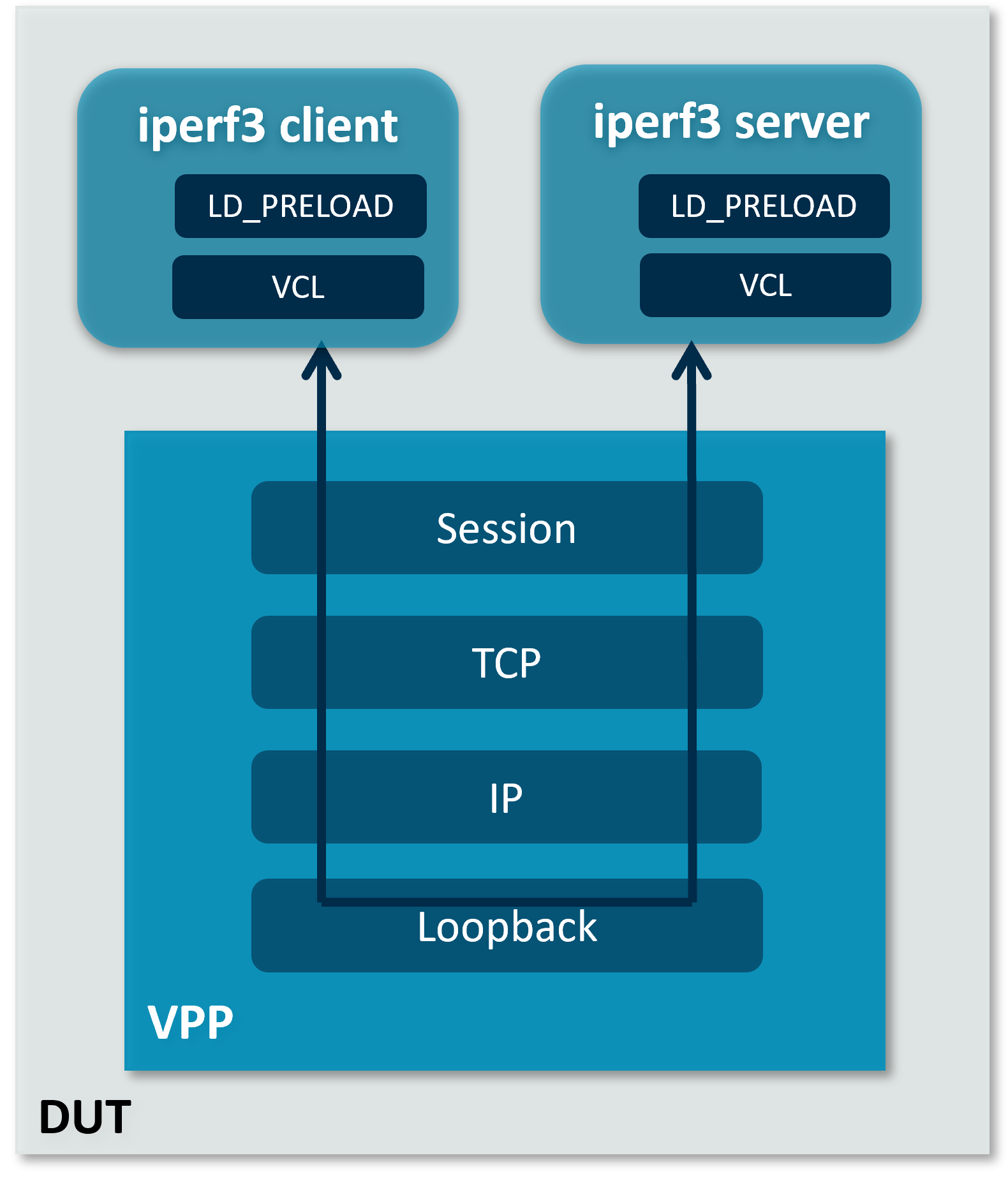

Loopback Connection
The loopback interface is a software virtual interface that is always up and available after it has been configured. In this setup, both iperf3 server and client run over VPP’s host stack on the DUT and communicate with each other through VPP loopback interfaces.
../_images/tcp_term_loop.png
Loopback connection
Note
This setup requires three isolated cores. Cores 1-3 are assumed to be isolated in this guide.

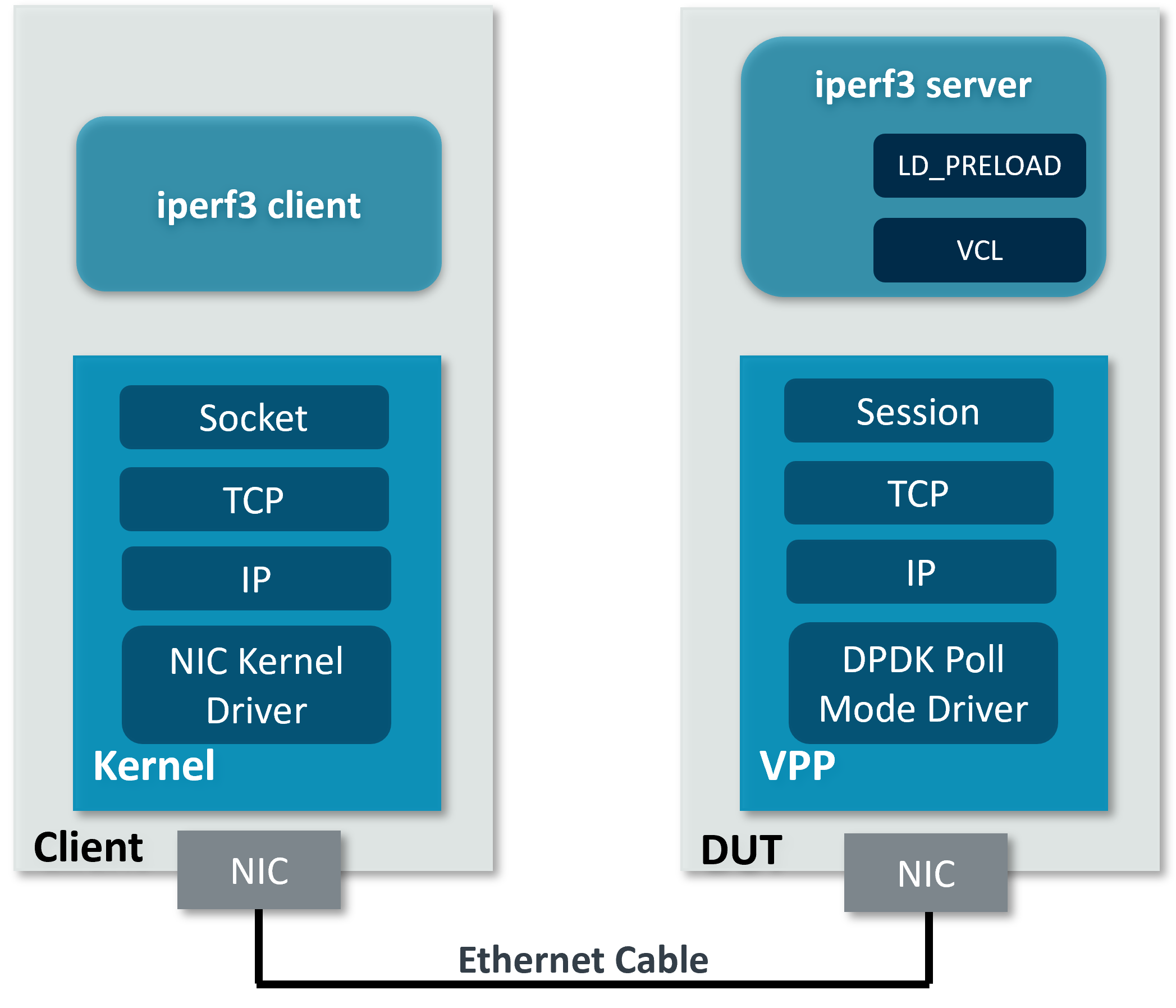

Ethernet Connection
In this TCP termination scenario, iperf3 server and client run on separated hardware platforms and are connected with Ethernet adapters and cables. iperf3 server runs over VPP’s host stack on DUT, and iperf3 client runs over Linux kernel stack on client node.
../_images/tcp_term_dpdk.png
Ethernet connection
To find out which DUT interface is connected to the client node, sudo ethtool --identify <interface_name> will typically blink a light on the NIC to help identify the physical port associated with the interface.

sudo ./vppctl -s ${sockfile} set interface state eth0 up
sudo ./vppctl -s ${sockfile} set interface ip address eth0 172.16.3.1/24
Declare a variable to hold the LD_PRELOAD library for VCL:
export LDP_PATH="$NW_DS_WORKSPACE/dataplane-stack/components/vpp/build-root/install-vpp-native/vpp/lib/aarch64-linux-gnu/libvcl_ldpreload.so"
Note
Any use of ~ in LDP_PATH will expand to the root user’s home directory when used later in the guide.
DUT iperf3 Server Setup
VCL parameters can be configured through VCL configuration file. A VCL configuration sample for iperf3 server is provided at $NW_DS_WORKSPACE/dataplane-stack/usecase/tcp_term/vcl_iperf3_server_pn.conf with the following contents:
vcl {
  rx-fifo-size 4000000
  tx-fifo-size 4000000
  app-scope-global
  app-socket-api /var/run/vpp/app_ns_sockets/default
The above configures VCL to request 4MB receive and transmit FIFO sizes and access to global session scope. For more VCL parameters usage, refer to VPP VCL reference.
VCL_CONFIG provides VCL with a configuration file to read during startup. Start the iperf3 server on core 2 as a daemon over VPP’s host stack, providing the VCL configuration file mentioned above:
sudo taskset -c 2 sh -c "LD_PRELOAD=${LDP_PATH} VCL_CONFIG=$NW_DS_WORKSPACE/dataplane-stack/usecase/tcp_term/vcl_iperf3_server_pn.conf iperf3 -4 -s -D"
To examine the iperf3 server session in VPP, use the command sudo ./vppctl -s ${sockfile} show session verbose. Here is a sample output for iperf3 server session:
Connection                                                  State          Rx-f      Tx-f
[0:0][T] 0.0.0.0:5201->0.0.0.0:0                         LISTEN         0         0
Test
On client node run the iperf3 client to connect to the iperf3 server on DUT:
sudo taskset -c 1 iperf3 -c 172.16.3.1
Note
Core 1 is assumed to be isolated on client node.
If both iperf3 client and server run successfully, measurement results will be printed by iperf3 client:
Connecting to host 172.16.3.1, port 5201
[  5] local 172.16.3.2 port 59118 connected to 172.16.3.1 port 5201
[ ID] Interval           Transfer     Bitrate         Retr  Cwnd
[  5]   0.00-1.00   sec  1.85 GBytes  15.9 Gbits/sec  183   1.39 MBytes
[  5]   1.00-2.00   sec  1.85 GBytes  15.9 Gbits/sec   44   1.37 MBytes
[  5]   2.00-3.00   sec  1.85 GBytes  15.9 Gbits/sec   26   1.35 MBytes
[  5]   3.00-4.00   sec  1.85 GBytes  15.9 Gbits/sec   33   1.54 MBytes
[  5]   4.00-5.00   sec  1.85 GBytes  15.9 Gbits/sec   42   1.64 MBytes
[  5]   5.00-6.00   sec  1.84 GBytes  15.8 Gbits/sec  110   1.35 MBytes
[  5]   6.00-7.00   sec  1.85 GBytes  15.9 Gbits/sec   24   1.54 MBytes
[  5]   7.00-8.00   sec  1.84 GBytes  15.8 Gbits/sec   35   1.38 MBytes
[  5]   8.00-9.00   sec  1.85 GBytes  15.9 Gbits/sec   27   1.21 MBytes
[  5]   9.00-10.00  sec  1.85 GBytes  15.9 Gbits/sec   21   1.41 MBytes
[  5]   0.00-10.00  sec  18.5 GBytes  15.9 Gbits/sec  545             sender
[  5]   0.00-10.00  sec  18.5 GBytes  15.9 Gbits/sec                  receiver
