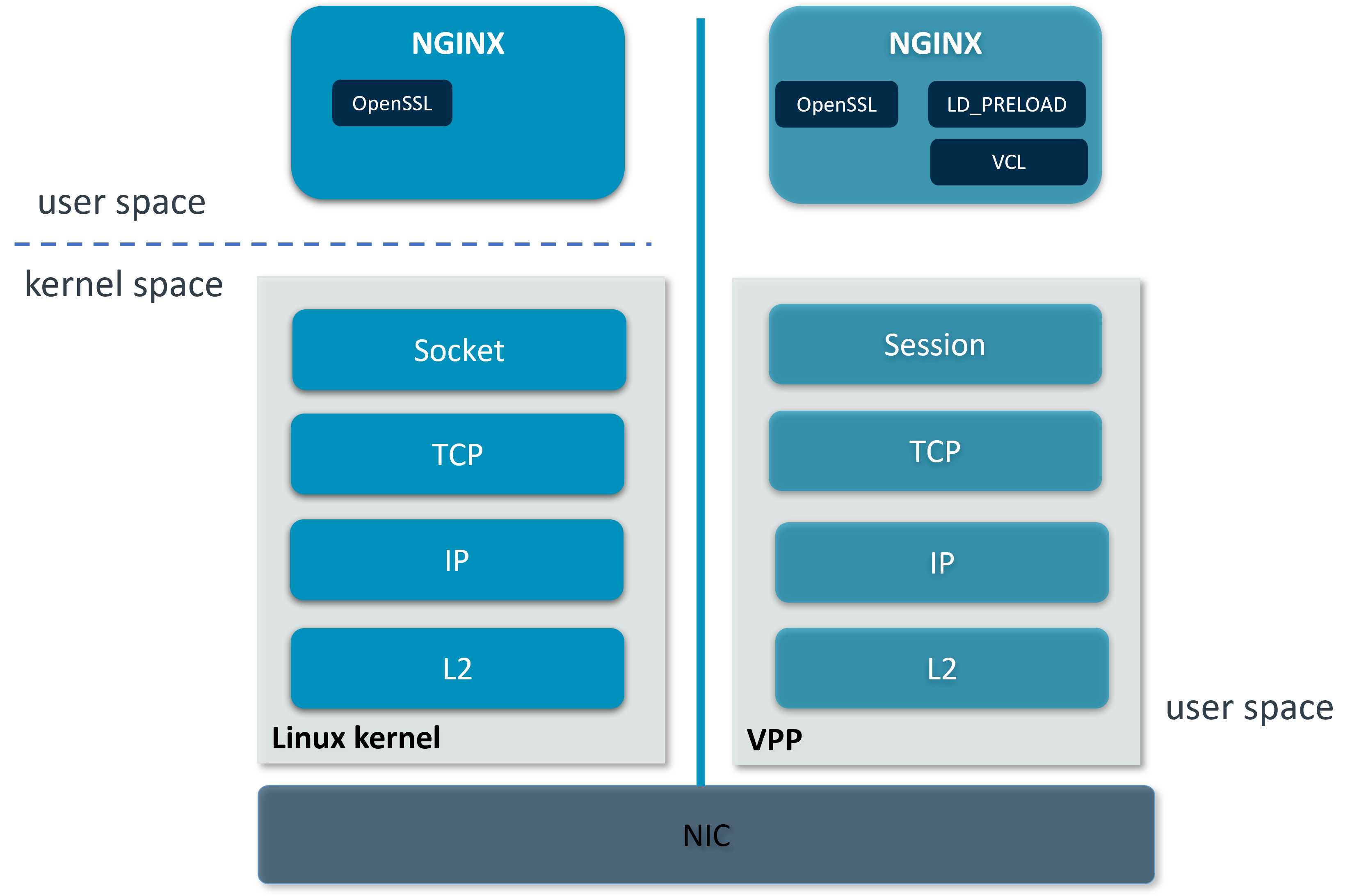

Network Stack Layers
../_images/nginx_kernel_vpp_stack.png
Linux kernel stack VS VPP’s host stack
VPP’s host stack provides alternatives to kernel-based sockets so that applications can take full advantage of VPP’s high performance. It implements a clean slate TCP that supports vectorized packet processing and follows VPP’s highly scalable threading model. The implementation is RFC compliant and supports many high-speed TCP protocol features. VPP’s host stack also provides a pluggable transport session layer that abstracts the interaction between applications and transports using a custom-built shared memory infrastructure. There is also VPP Comms Library (VCL) included to ease the consumability of the stack from application perspective. VCL manages the interaction with the session layer, abstracts session to integer session handles and exposes its own asynchronous communication functions.
This guide demonstrates two kinds of SSL reverse proxy connection:
  • Loopback connection on DUT node
  • Ethernet connection between DUT and client/server nodes

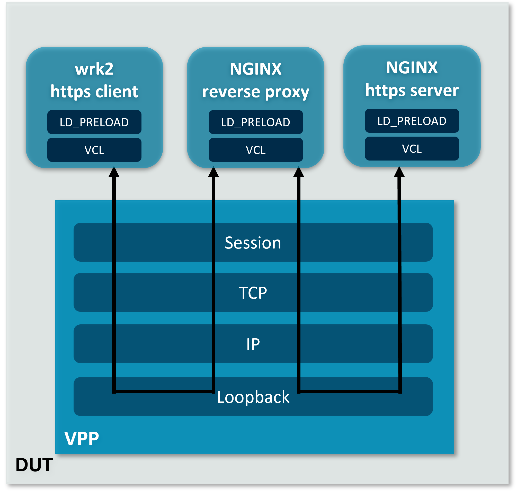

Loopback Connection
The loopback interface is a software virtual interface that is always up and available after it has been configured. In this setup, NGINX HTTPS server, NGINX reverse proxy and wrk2 client run over VPP’s host stack on DUT and communicate with each other through VPP loopback interfaces.
../_images/ssl_proxy_loop.png
Loopback connection
Note
This setup requires four isolated cores. Cores 1-4 are assumed to be isolated in this guide. VPP, wrk2, NGINX HTTPS server and NGINX reverse proxy each require an isolated core.

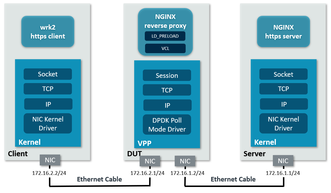

Ethernet Connection
In this SSL reverse proxy scenario, NGINX HTTPS server, NGINX reverse proxy and wrk2 HTTPS client run on separated hardware platforms. The DUT has one NIC interface connected with the server node, and another NIC interface connected with the client node. NGINX reverse proxy runs over VPP’s host stack on DUT. NGINX HTTPS server runs over Linux kernel stack on server node. wrk2 HTTPS client runs over Linux kernel stack on client node.
../_images/ssl_proxy_dpdk.png
Ethernet connection
To find out which DUT interfaces are connected with HTTPS client/server nodes, sudo ethtool --identify <interface_name> will typically blink a light on the NIC to help identify the physical port associated with the interface.

ifconfig <interface_name> <ip_address>
In this setup example:
  • enP1p1s0f0 at PCIe address 0001:01:00.0 is used to connect with the client node. The IP address of this NIC interface in VPP is configured as 172.16.2.1/24.
  • enP1p1s0f1 at PCIe address 0001:01:00.1 is used to connect with the server node. The IP address of this NIC interface in VPP is configured as 172.16.1.2/24.
  • The IP address of the client node NIC is 172.16.2.2/24.
  • The IP address of the server node NIC is 172.16.1.1/24.
Install git and building tools on the client node. If running Ubuntu 22.04 or later, apt install git build-essential will be sufficient. For other Linux distributions, please consult the package manager for equivalent one.
Install NGINX on the server node. If running Ubuntu 22.04 or later, apt install nginx will be sufficient. For other Linux distributions, please consult the package manager.
