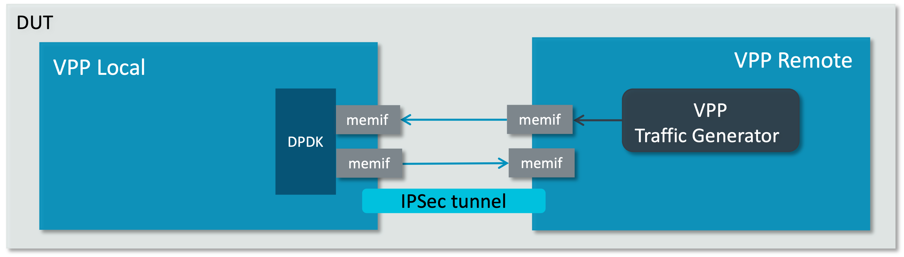

Memif Connection
Shared memory packet interface (memif) is a software emulated Ethernet interface, which provides high performance packet transmit and receive between VPP and user application or multiple VPP instances.
In this setup, there are two VPP instances named Local
and Remote
, connected with two pairs of memif interfaces.
On the Local
VPP instance, the DPDK zero-copy memif interfaces are used for testing VPP + DPDK stack.
On the Remote
VPP instance, the VPP’s native memif interfaces are used for performance reason.
The Local
instance receives unencrypted packets from one DPDK memif interface and forwards them in an encrypted form through another DPDK memif interface.
The Remote
instance is configured as a traffic generator for unencrypted packets while also capable of receiving encrypted packets from one memif interface and decrypting them.
Here is the topology:
Memif connection
Users can quickly run VPP instances and set up IPSec session through the provided scripts
located at: $NW_DS_WORKSPACE/dataplane-stack/usecase/ipsec

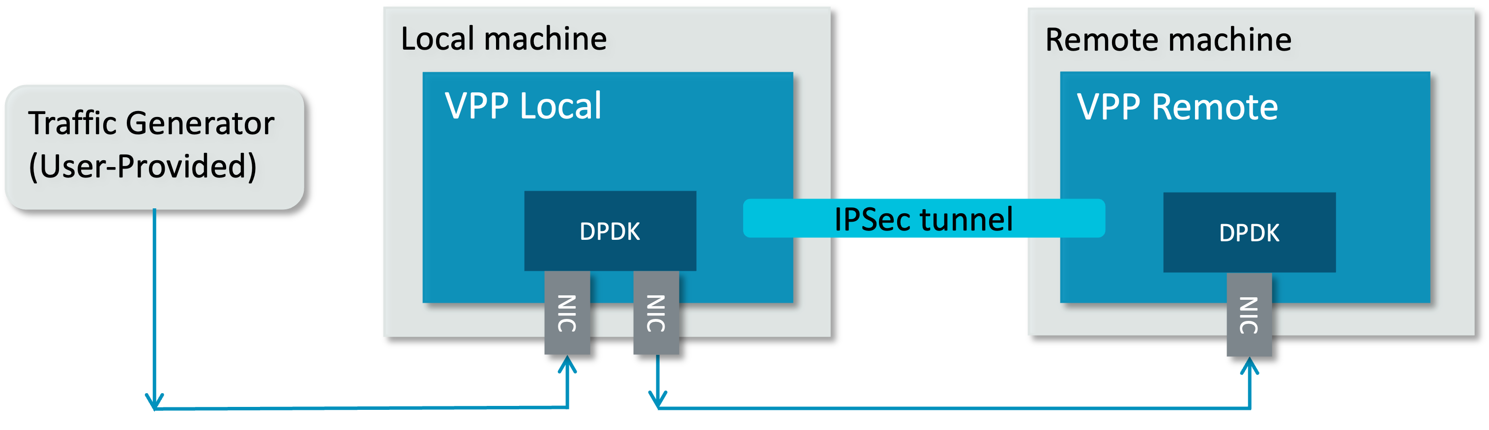

In this IPSec scenario, the Local
and Remote
VPP instances run on separate hardware platforms and are connected together via Ethernet adapters and cables.
The traffic generator could be software-based, e.g., VPP/TRex/TrafficGen running on regular servers, or hardware platforms, e.g., IXIA/Spirent Smartbits.
Ethernet connection
Before starting, all the required interfaces, illustrated above, need to be identified. These are the interfaces connecting the Local
machine to the
traffic generator and to Remote
, which in turn has an interface connecting back to Local
The interface names and PCIe addresses can be fetched by running sudo lshw -c net -businfo

On Local
the output will look like:
Bus info Device Class Description
pci@0001:01:00.0 enP1p1s0f0 network MT27800 Family [ConnectX-5]
pci@0001:01:00.1 enP1p1s0f1 network MT27800 Family [ConnectX-5]
Whereas on Remote
it will look like:
pci@0000:01:00.0 enp1s0f0np0 network MT28800 Family [ConnectX-5 Ex]
In this example setup, enP1p1s0f0
at PCIe address 0001:01:00.0
on Local
is connected to the traffic generator,
enP1p1s0f1
at PCIe address 0001:01:00.1
on Local
and enp1s0f0np0
at PCIe address 0000:01:00.0
on Remote
are interconnected.
Users can quickly run the VPP instances and set up the IPSec session through the provided scripts
Overview
In an Ethernet connection scenario, the main operations of each script are as follows:
run_vpp_remote.sh
Run the
Remote
VPP instance on the specified CPU coresAttach one DPDK interface to the specified PCIe address to VPP
Bring the interface up and set an interface IP address
run_vpp_local.sh
Run the
Local
VPP instance on the specified CPU coresAttach two DPDK interfaces to the specified PCIe addresses to VPP
Bring the interfaces up and set the interfaces IP addresses
ipsec_remote_setup.sh
Set up IPSec on the Remote
VPP instance.
Set the crypto engine as specified
Create a Security Policy Database (SPD)
Enable SPD on the interface sending packets from local to remote
Create a Security Association (SA), a set of security parameters
Add a SPD entry
Add the IP route entries
Create an IP-in-IP tunnel
Add the SA to IP-in-IP tunnel
ipsec_local_setup.sh
Set up IPSec on the Local
VPP instance.
Enable SPD on an interface sending packets from local to remote
Add a SPD entry
stop.sh
Stop both
Local
andRemote
VPP instances
traffic_monitor.sh
Monitor IPSec throughput with the VPP
show runtime
command
Execution
On the Local
machine declare a variable to hold VPP’s IPSec configuration:
export IPSEC_CONFIG=policy
export IPSEC_CONFIG=protection
Note
The below setup requires at least one isolated core for VPP workers on every machine. Core 2 is assumed to be isolated on the
Local
machine.
Quickly set up the Local
VPP instance and set up IPSec session:
cd $NW_DS_WORKSPACE/dataplane-stack
./usecase/ipsec/run_vpp_local.sh -p 0001:01:00.0,0001:01:00.1 -c 1,2
./usecase/ipsec/ipsec_local_setup.sh -p -e native -a aes-gcm-128 --config ${IPSEC_CONFIG}
This setup will run the Local
VPP instance on specified CPU cores and configure two physical NIC.
Furthermore, it will establish an IPSec session through physical NIC using native
crypto engine, aes-gcm-128
cipher algorithm and specified configuration.
On the Remote
Note
The setup below assumes that core 2 is isolated on the
Remote
machine.Local
andRemote
VPP instances need to be configured in the same IPSec mode.
Quickly set up the Remote
./usecase/ipsec/run_vpp_remote.sh -p 0000:01:00.0 -c 1,2
./usecase/ipsec/ipsec_remote_setup.sh -p -e native -a aes-gcm-128 --config ${IPSEC_CONFIG}
This setup will run the Remote
VPP instance on specified CPU cores and configure one physical NIC.
Furthermore, set up IPSec session through physical NIC using native
Note
Replace the sample addresses in the above command with your PCIe addresses for the
Local
andRemote
machines.
On the Local
machine enP1p1s0f0
is connected to the traffic generator, get the enP1p1s0f0
MAC address via ip link show enP1p1s0f0
10: enp1s0f0np0: <BROADCAST,MULTICAST,UP,LOWER_UP> mtu 8996 qdisc mq state UP mode DEFAULT group default qlen 1000
link/ether b8:ce:f6:10:e4:6c brd ff:ff:ff:ff:ff:ff
In this case, configure the traffic generator to send packets to Local
VPP with a destination MAC address of b8:ce:f6:10:e4:6c
, a source IP address 192.81.0.1
and a destination IP address of 192.82.0.1
then Local
VPP will encapsulate the received packets using a new IP header with destination IP address 192.162.0.1
, encrypt the original packets and forward the encrypted ones through the IPSec tunnel to the Remote
VPP instance.
Now, monitor the IPSec throughput with traffic_monitor.sh
