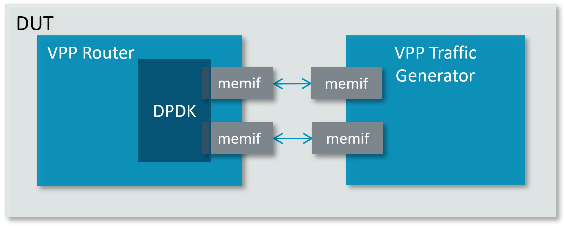

Memif Connection
Shared memory packet interface (memif) is software emulated Ethernet interface, which provides high performance packet transmit and receive between VPP and user application or multiple VPP instances.
In this setup, two pairs of memif interfaces are configured to connect VPP L3 router instance and VPP based traffic generator. On VPP router side, DPDK zero-copy memif interfaces are used for testing VPP + DPDK stack. On VPP traffic generator side, VPP’s native memif interfaces are used for performance reason.
Memif connection
The user can quickly run VPP L3 forwarding over memif connection using the scripts
located at: $NW_DS_WORKSPACE/dataplane-stack/usecase/l3_forwarding

In memif connection scenario, the main operations of each script are as follows:

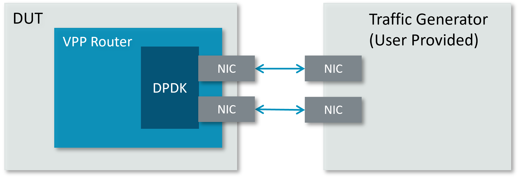

Ethernet Connection
In this L3 forwarding scenario, DUT and traffic generator run on separated hardware platforms and are connected with Ethernet adapters and cables. The traffic generator could be software-based, e.g., VPP/TRex/TrafficGen running on regular servers, or hardware platforms, e.g., IXIA/Spirent Smartbits.
Ethernet connection
Find out which DUT interfaces are connected to the traffic generator.
sudo ethtool --identify <interface_name>
will typically blink a light on the NIC
to help identify the physical port associated with the interface.

The user can quickly run VPP L3 forwarding over NIC connection using the scripts located
Overview
In Ethernet connection scenario, the main operations of each script are as follows:
